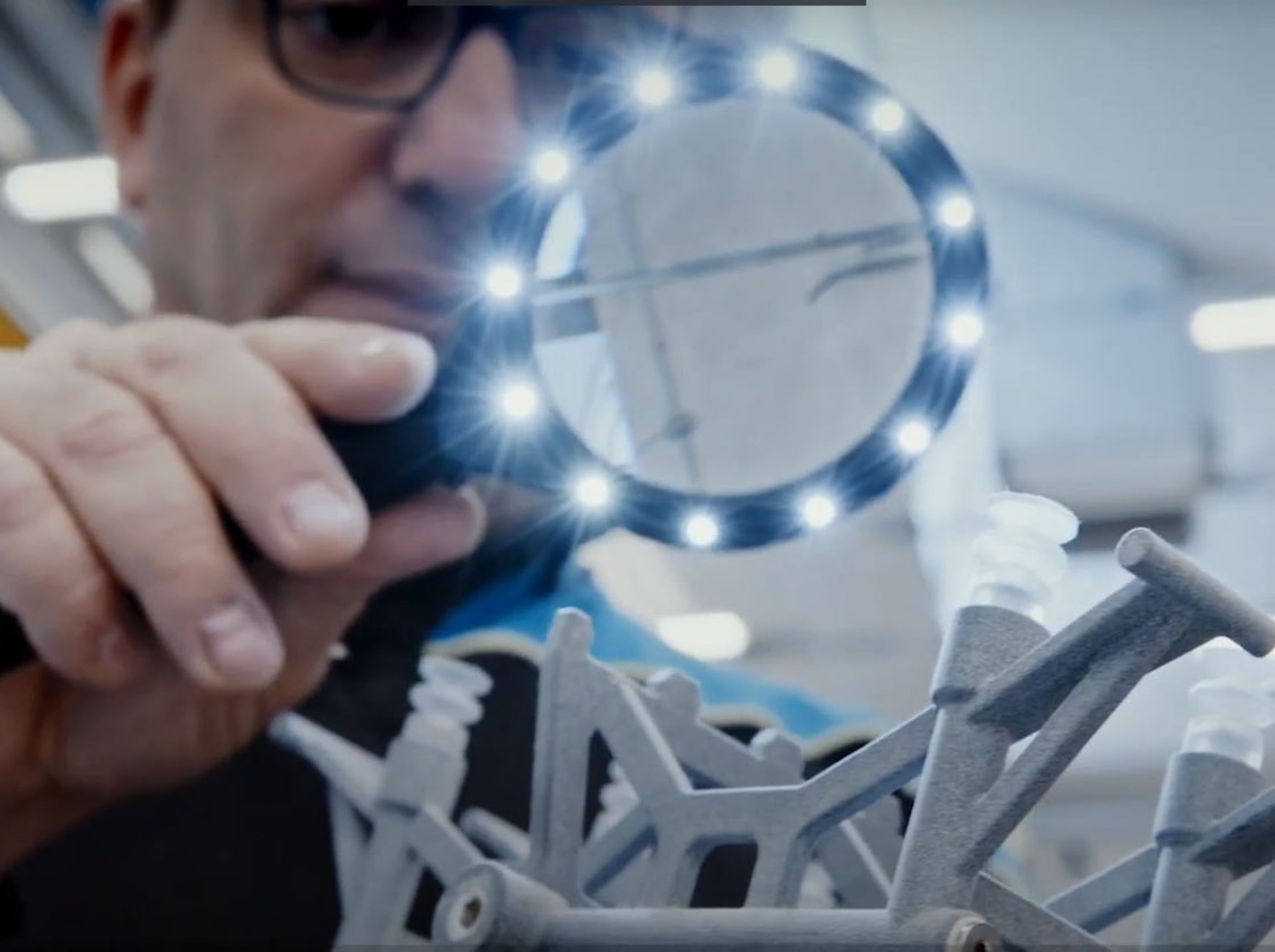

  1. Data courtesy of Campetella Robotic Center
