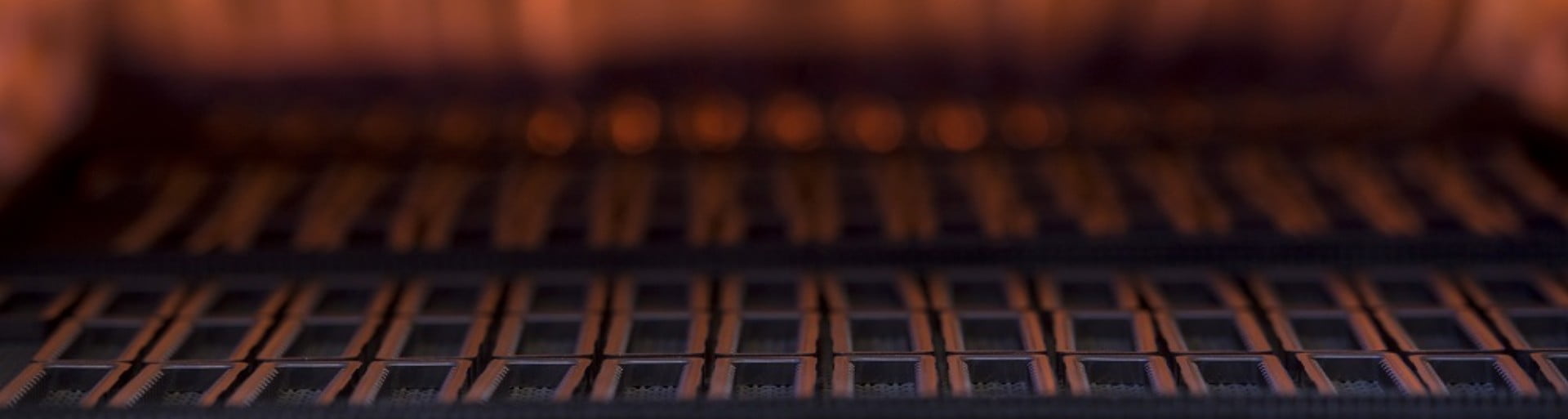

4. Sintering
The green parts are sintered at temperatures below the melting point. During this process, metal particles are bound by atomic diffusion at the surface to form a matrix that can reach up to 98 percent solid density. While the green parts are sintered, they are shrinking by 18 percent to 20 percent in each dimension. The remaining binders decompose.
