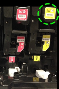

  3. Check the position of the Toner GatePicture of the Gate of Toner Cartridge. on the Toner Cartridge and Image Drum to ensure that toner is flowing from the Toner Cartridge into the Image Drum:
    1. Remove the yellow toner cartridge Picture of the printer cartridge., Show me how, and rock it gently.

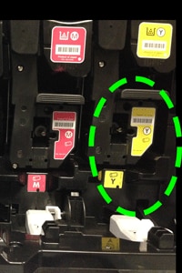

    2. Remove the yellow image drum Picture of the image drum., Show me how.
    3. Check the plastic pins on the yellow toner cartridge Picture of the printer cartridge., and ensure that they are not broken. Show me how.
    4. If the plastic pins are broken, replace the toner cartridge, Show me how.
    5. Examine the toner gates on the yellow toner cartridge Picture of the printer cartridge.. Make sure that they are in closed position. Show me how.
    6. Examine the toner gates on the yellow image drum Picture of the image drum.. Make sure that they are in closed position. Show me how.
    7. Reinsert the yellow image drum. Show me how.
    8. Reinsert the yellow toner cartridge. Show me how.
