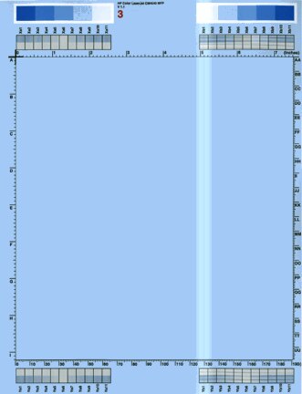

Fig. Cyan-1.6
As shown below, the issue may vary in location and appearance. Click a sample image below to see a larger version of it.

White vertical line(s) or band(s).
