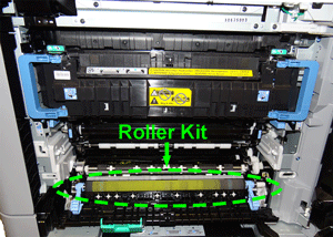

Mark(s) repeating every 71.5 mm on the backside of pages. May occur after clearing a paper jam.
Most likely causes
  • Secondary transfer roller is likely to have contamination on it.
Troubleshooting and suggestions
  1. Print 1-30 pages to clear the contamination.
  2. If the backside 71.5 mm repetitive issue does not clear, replace the roller kit Picture of the roller kit..
  3. Print another set of pages, if performing the above procedures does not eliminate the issue, Contact HP.
