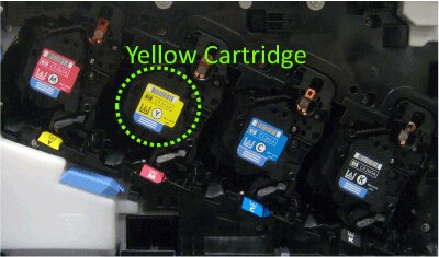

Figure 2: Locate the yellow print cartridge
example
2. Locate the yellow print cartridge.
Figure 3: Release the yellow print cartridge
example
3. Grasp the handle of the yellow print cartridge and pull it toward yourself to release the cartridge from its slot.

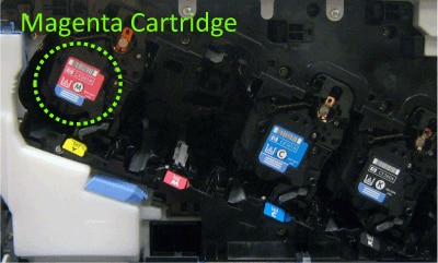

Figure 5: Locate the magenta print cartridge
example
5. Locate the magenta print cartridge.
Figure 6: Release the magenta print cartridge
example
6. Grasp the handle of the magenta print cartridge, and pull it towards yourself to release the cartridge from its slot.

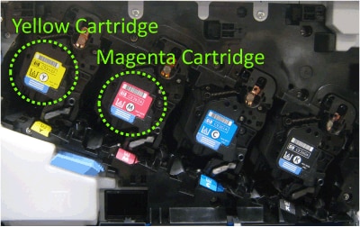

Figure 12: Check the order of the yellow and magenta print cartridges
example
12. Check the order of the yellow and magenta print cartridges, to be sure that it is the same as shown in Figure 12 on the left.
