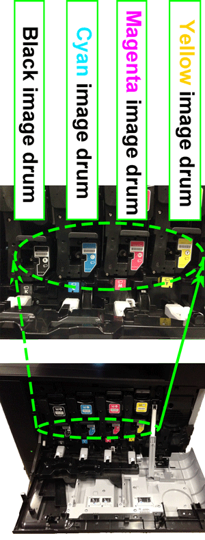

Figure 2: Locate all the image drums
example
2. Locate all the image drums.
