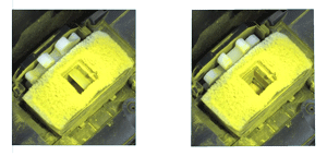

Here are examples of a toner gate that is partially open, and one that is completely open.
example
