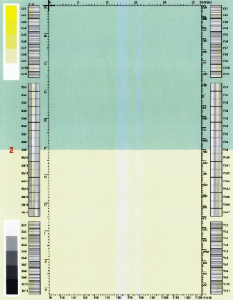

White vertical line(s) or band(s)
Fig. Greenyellow-1.5
As shown below, the issue may vary in location and appearance. Click a sample image below to see a larger version of it.
Fig. Greenyellow-1.1
Fig. Greenyellow-1.2
Fig. Greenyellow-1.3
Fig. Greenyellow-1.4
Fig. Greenyellow-1.6
Description
White vertical line(s) or band(s) down the page in yellow part, or blue vertical line(s) or band(s) down the page in the green part.
Most likely causes
  • Lint or other foreign object on the scanner glass under the yellow print cartridge Picture of the printer cartridge. that is blocking the laser. See Fig. Greenyellow 1.1 - Fig. Greenyellow 1.3 as examples.
  • Toner on the scanner glass under the yellow print cartridge that is blocking the laser. See Fig. Greenyellow 1.4 - Fig. Greenyellow 1.6 as examples.
  • A drum or cylinder inside the printer has been scratched around its circumference.
  • The print cartridge is near the end of its life.
