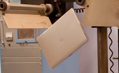

Drop
Drop
The Drop test was performed in accordance with MIL-STD-810G, Method 516.6 Procedure IV. The objective of this test was to determine whether the unit could be safely operated after being dropped from desk height. For this test, 26 drops were performed from 30 in. onto every side, angle and edge onto 2 in. of plywood over steel over concrete. Unit is powered down and checked for operation.

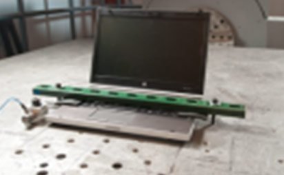

Physical Shock
Physical Shock
The Shock test was performed in accordance with MIL-STD-810G, Method 516.6 Procedure I. The objective of this test was to determine whether the unit could be safely operated after being exposed to sudden physical shock events while operational. For this test, 3 shocks were performed across each axis and direction for a total of 18 shocks.

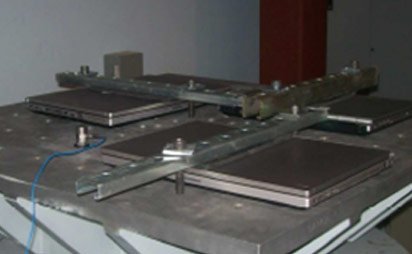

Vibration
Vibration
The Vibration Resistance test was performed in accordance with MIL-STD-810G Test Method 514.6, Procedure I(Non- operational) and Procedure II (Operational). Test parameters were set to simulate the following:
• Operate the unit during a 1000-mile simulation of vibrations created by a truck driving on a U.S. highway.
• Operate the unit after it has been subjected to higher levels of vibration while in storage.
Terrain, road and surface discontinuities, vehicle speed, loading, structural characteristics, and suspension system are all reflected in this simulation.

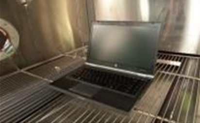

High/low temperature
The High Temperature test was performed in accordance with MIL-STD-810G, Method 501.5, Procedure I (Storage) and II (Operation). This test evaluated the units’ performance while it was being exposed to high temperature conditions: 60°C (140°F) operational and 71°C (160°F) non-operational. The Low Temperature test was performed in accordance with MIL-STD-810G, Method 502.5,Procedure I (Storage) and II (Operation). This test evaluated the unit’s performance while it was being exposed to low temperature conditions: -29°C (-20°F) operational and -51°C (-60°F) non-operational.

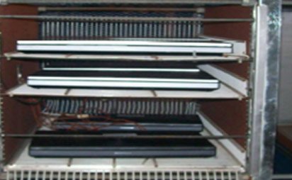

Altitude
Altitude
The Altitude test was performed in accordance with MIL-STD-810G, Method 500.5, Procedure I (Storage) and II (Operation). The altitude level simulated for both procedures was 15,000 feet (the highest equivalent altitude given within MIL-STD-810G for cargo pressures within military aircraft).

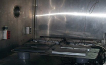

Humidity
Humidity
The Humidity test was performed in accordance with MIL-STD-810G, Method 507.5, Procedure II with the aggravated temperature-humidity cycle. Each cycle was one day (24 hours); ten cycles with the temperature being cycled between 30°C (86°F) and 60°C (140°F); and relative humidity was a constant 95%.
