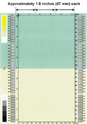

Vertical lines repeating every 1.9 inches (47 mm)
Fig. Greenyellow-5-1.1
As shown below, the issue may vary in location and appearance. Click a sample image below to see a larger version of it.
Fig. Greenyellow-5-1.2
Fig. Greenyellow-5-1.3
Description
Pages print with thin vertical lines in the color of blue in the green part, repeating every 1.9 inches (47 mm).
