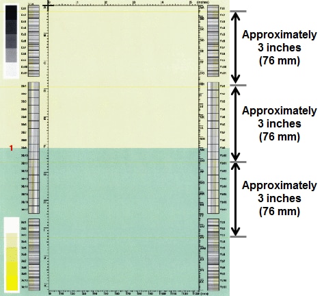

As shown below, the issue may vary in location and appearance. Click a sample image below to see a larger version of it.
Description
Thin horizontal lines in the color of the new print cartridge. Only one repeating line may be seen, repeating every 3.0 inches (76 mm).
