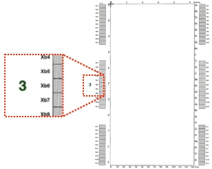

- Look at the center of left margin of the test pages No. 3 and No. 4.
Confirm that test page No. 3 is now white, and test page No. 4 is now cyan.
If this is not true, then you may have swapped the wrong cartridges. Repeat Step 3, the cartridge swap procedure. - As illustrated below, if the background color of the test page No. 3 is not magenta,
replace the magenta print cartridge with a new magenta print cartridge. Show me how.
Otherwise, Contact HP.
