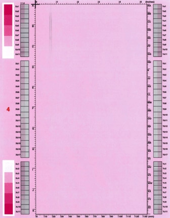

Color Definition: Magenta:
Fig. Magenta-2.4
As shown below, the issue may vary in location and appearance. Click a sample image below to see a larger version of it.
Description
One or more vertical line(s). The line(s) may extend continuously from the top to the bottom of the page, or they may consist of shorter line segment(s). The line(s) can occur anywhere on the page. The issue may start out as one line, with more lines appearing over time as the issue gets worse. These lines may appear on all five test pages.
Most likely causes
- Damage to the fuser
sleeve (especially cracks or tears on the fuser sleeve).
- Debris in the transfer unit
(especially paper dust, adhesive, or fragments from labels).
- Damage to the transfer unit (especially from media problems, staples, or poor quality paper).
