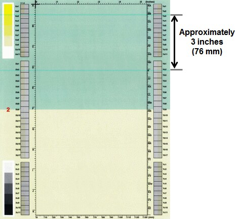

Horizontal Lines Repeating Every 3.0 Inches (76mm) in the green part
HP Color LaserJet Enterprise 500 Color Printer M551 series
Color Definition:    Greenyellow:
Horizontal lines repeating every 3.0 inches (76 mm)
Fig. Greenyellow-5-2.2
As shown below, the issue may vary in location and appearance. Click a sample image below to see a larger version of it.
Fig. Greenyellow-5-2.1
Description
Pages print with thin horizontal lines in the color of blue in the green part. Only one repeating line may be seen, repeating every 3.0 inches (75.5mm).
Most likely causes
Troubleshooting and suggestions
  1. If the issue shown above occurs at first installation. Turn off the printer, wait one minute, and turn it back on. This will rotate the internal cyan print cartridge Picture of the printer cartridge. components from its original position. The 3.0 inches (76 mm) repeating line should disappear after 24-48 hours.
