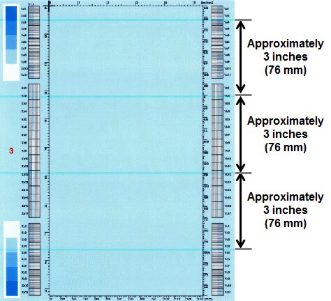

Horizontal Lines Repeating Every 3.0 Inches (76mm)
HP Color LaserJet Enterprise 500 Color Printer M551 series
Color Definition:    Cyan:
Horizontal lines repeating every 3.0 inches (76 mm)
Fig. Cyan-4-2.2
As shown below, the issue may vary in location and appearance. Click a sample image below to see a larger version of it.
Fig. Cyan-4-2.1
Fig. Cyan-4-2.2
Description
Thin horizontal lines in the color of the new print cartridge. Only one repeating line may be seen, repeating every 3.0 inches (76 mm).
Most likely causes
Troubleshooting and suggestions
  1. If the issue shown above occurs at first installation. Turn off the printer, wait one minute, and turn it back on. This will rotate the internal cyan (blue) print cartridge Picture of the printer cartridge. components from its original position. The 3.0 inches (76 mm) repeating line should disappear after 24-48 hours.
  2. After 48 hours, print and examine a set of PQ troubleshooting pages. Show me how.
  3. If the issue is not resolved or the issue shown above did not occur at first installation, the cyan print cartridge is damaged. Replace the cyan print cartridge with a new cyan print cartridge. Show me how.
