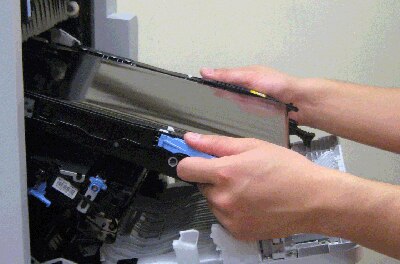

Figure 4: Pull the transfer unit
example
4. Pull the transfer unit straight toward yourself gently until two large blue side handles expand along the right and left sides of the transfer unit.
Figure 5: Switch your hands
example
example
5. Switch one of your hands to the location of the large blue handle on the side of the transfer unit as shown in Figure 5, and then switch the other hand.
CAUTION: Do not touch the shiny black surface of the belt on the top of the transfer unit, or place anything on it. This may damage the transfer unit and cause print quality problems.
CAUTION: As you pull the transfer unit part way out, be careful to maintain its alignment with the slot that holds it in the printer. The transfer unit should come out easily.
wrong
right
