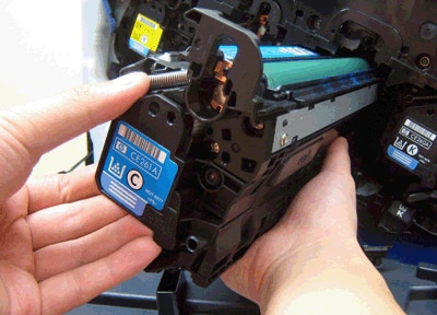

Figure 5: Align the new cyan print cartridge
example
5. Make sure the new cyan print cartridge is correctly aligned before trying to insert it into the slot.
Figure 6: Insert the cyan print cartridge
example
6. Gently push the cyan print cartridge into its slot until it clicks into place.
