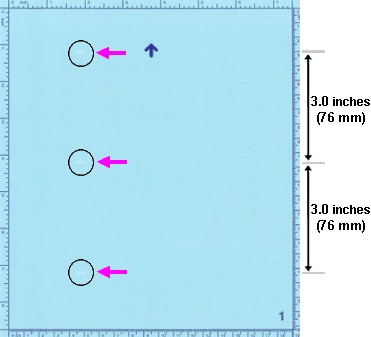

TOP - leading edge of paper as it exits printer More information on the orientation of the paper. Clicking this icon will open a new window.
Fig. Cyan-6.1
As shown below, the issue may vary in location and appearance. Click the sample image below to see a larger version of it.
sample1
Fig. Cyan-6.1
sample2
Fig. Cyan-6.2
sample3
Fig. Cyan-6.3
Description
White marks repeating vertically every 3.0 inches (76 mm) down the page.
